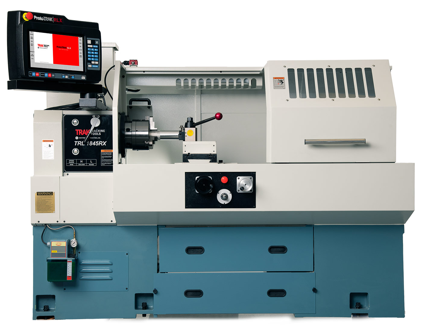

TRAK TRL 1845RX Toolroom Lathe Generous capacities and excellent performance over its entire range of motion
Specifications for the TRAK TRL 1845RX Toolroom Lathe
  • Swing Over Bed: 18″
  • Distance Between Centers: 45″
  • Spindle Through Hole: 2.36″
  • Spindle Speed Range RPM: 80 - 850, 250 - 2,500
Key Features of the TRAK TRL 1845RX Toolroom Lathe
  • ProtoTRAK RLX CNC integrated into the machine at the factory
  • Manual or CNC operation
  • Electronic handwheels and jogstick
  • Brushless servo motors
  • Inverter-duty spindle drive
  • Programmable spindle speeds
  • Constant Surface Speed (CSS) Programming
  • Inch Per Revolution (IPR) Programming
  • Optional TRAKing® for manual control of CNC programs
  • Optional turret for automatic tool changes
