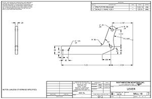

In Part 3, TRAKing Pat programs a part with a lot of missing dimensions using the ProtoTRAK RMX CNC. He details how powerful the A.G.E. can be in situations like these, and goes on to fill in the missing dimensions with the extremely useful Guess Feature.
